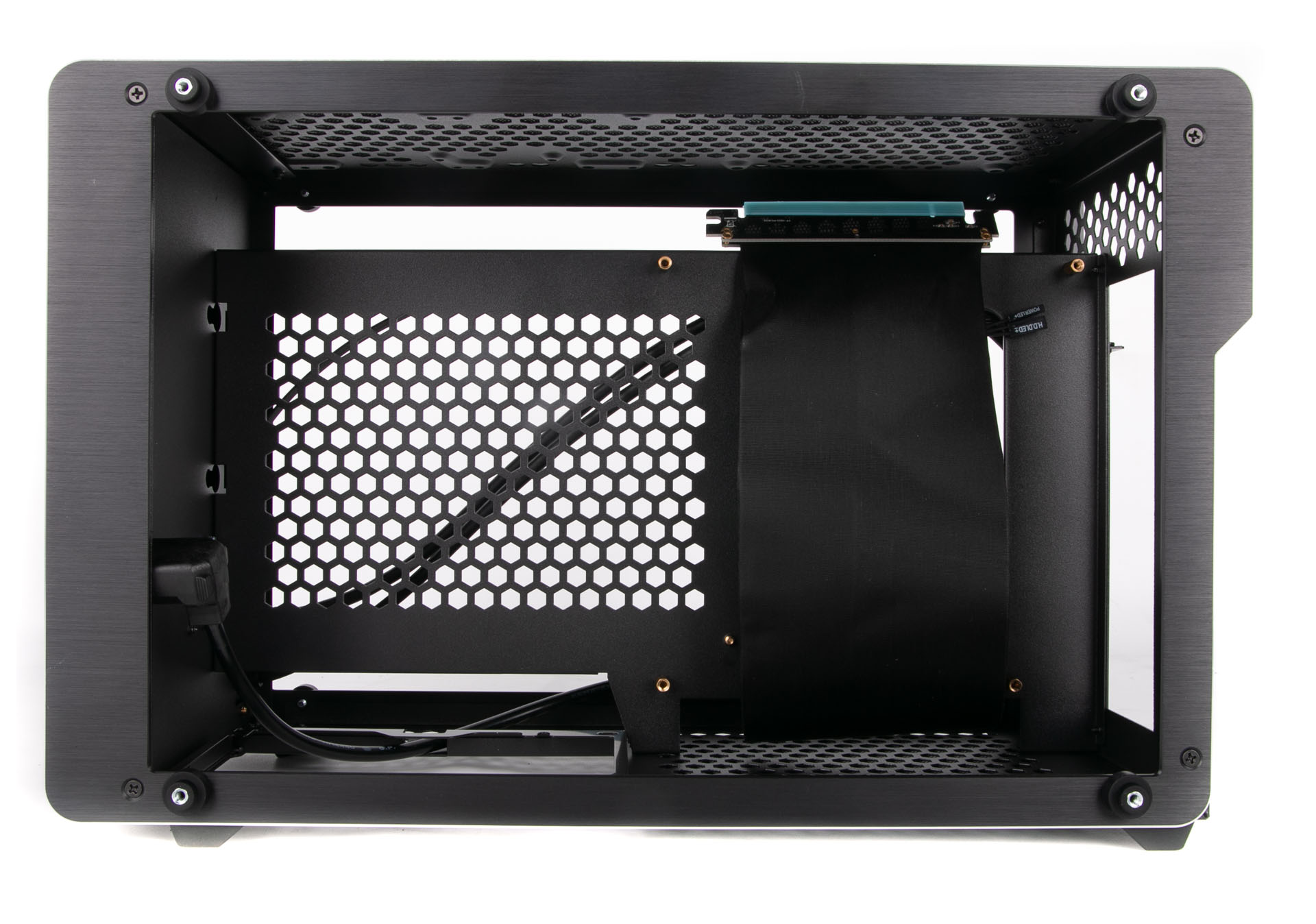

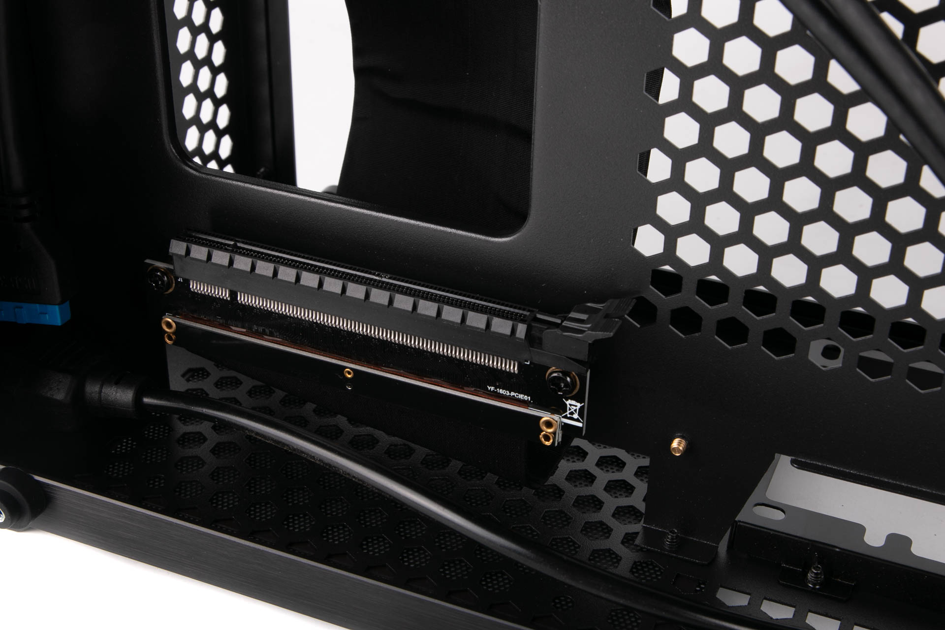

It's a shame a small U-shaped cut out couldn't have been made above the perforations in the motherboard tray, as this would have solved the issue at a stroke.The PCIe riser cable is threaded underneath the motherboard to the other side of the case, with the mount for the graphics card located low enough to allow monster-wide cards to be installed with the mount itself acting as a support for the card along with the expansion slots.
There's a small gap under the motherboard tray for routing cables, so this is probably the best way to avoid fouling any roof fans you install - if your cables are long enough that is. The roof is one location you can install fans, but you do get an additional 120mm mount in the base of the case - that's two more than the Metis, and with the larger Ophion Evo there's enough clearance above the motherboard tray to house a 240mm AIO liquid cooler, so plenty of scope in terms of cooling for housing a high-end overclocked PC.
